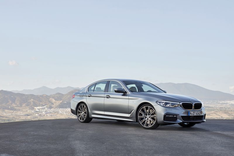

  • Vorteile und Nachteile. Ehrlich gesagt habe ich keine langfristigen Zweifel an der Zuverlässigkeit des BMW 225xe, aber ich bin eher besorgt über den Fahrkomfort.
    Über 530e:
    The plug-in hybrid system of both models consists of a 2.0 liter 4-cylinder gasoline engine with BMW TwinPower Turbo Technology generating an output of 135 kW/184 hp as well as an 83 kW/113 hp electric motor, which is integrated into the 8-speed Steptronic transmission.
    https://www.greencarcongress.com/2019/08/20190803-bmw.html
    Oder
    https://insideevs.com/news/364479/bmw-specs-new-530e-phev/
    Und BMW i3:
    At the heart of the BMW i3 is a bespoke electric motor tagged BMW eDrive, which its maker also refers to as hybrid synchronous in design. It was developed in-house and is also used in the BMW i8. It's mounted at the back of the car and drives the rear wheels through a single-speed transmission. Although it revs to 11,400rpm and produces up to 168bhp, it's the torque output (184lb ft) that matters most, as it's available from the second you press the accelerator.
    https://www.evo.co.uk/bmw/i3/page/0/2
    Das Drehmoment wird nicht in Umdrehungen pro Minute angegeben, sondern in XXX Nm bei XXXX Umdrehumgen pro Minute.
    Der Elektro-Motor des 530e hat laut dem Link 250Nm Drehmoment bei 0 bis 3170 Umdrehungen pro Minute.
